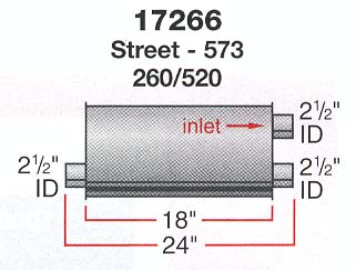

Compare the same muffler (and same number)
F-body style Ultraflow SS: 573cfm
F-body style Super Turbo: 385cfm
The ultraflow (straight through design) flows 49% more air. That's a significant increase even on this poor muffler design!
17281 (UF): 700cfm
17730 (ST): 260cfm
That's a 169% increase for comparable SVT style mufflers.
(Though neither are not bolt in. The body is much longer! The SVT uses tiny 10" mufflers)
We won't even throw in the Welded series which outflows the SS series & is cheaper to boot! laugh

DemonSVT,
Here is my reasoning...btw not a fight cool
Yes, Ultraflow Welded and SS are awesome, but expensive. My point is the flow of two mufflers is as good as one expensive muffler, especially for an SE.
According to Dynomax,
Looking at the numbers the 17730 would flow 520 with duals.
Single 17266 would flow 573.
Dual 17733 would flow 820.
See my point?
I will run a single 17733 for 420 flow or good for 186 RWHP according dynomax.

BTW - that's "Crank" HP they rate them at...
So 186 Crank HP for a single 2.5" ST on 2.5" piping. (yes the entire system must be the same size in order to use that HP rating)
...and like Aussie said. Turbo mufflers really do not perform well. Especially at higher rpms! Dynomax ST is the best turbo muffler out there and it's still barely passable...
Red contour - if you look at my second post I posted the stock SVT mufflers are 10" in length. They are a unique size unfortunately.
Getting a 14" bodied muffler to fit would take some custom piping work.
Then if you are going to redo the duals. Might as well go 2.25" mandrel.
If you are doing that you might as well replace the crappy stock Y-split.
Then all you are left with is the factory 2.25" mandrel single piping...
