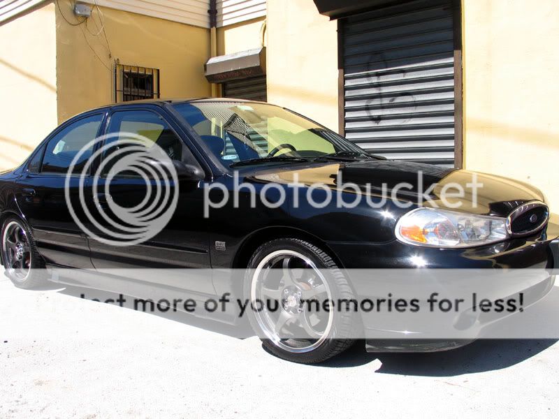

I recently put on a set of rev Type X rims and Toyos and painted my calipers black, and the combo looks very nice. The problem I have is that the rotors are rusted around the circumferece and around the hub. You can see the rust clearly even at this distance:
These are rotors I got from Stazi and have been really happy with their performance.
Is it worth it to have the rust removed and the rotors plated, or should I just get plated rotorsand replace them? The turnaround on just replacing them would be faster, since I could just do that with my next brake job.
Any recommendations for replacements that won't rust? Anyone know if Stazi offers rustproof rotors, or if new ones from him could be plated after the fact?
