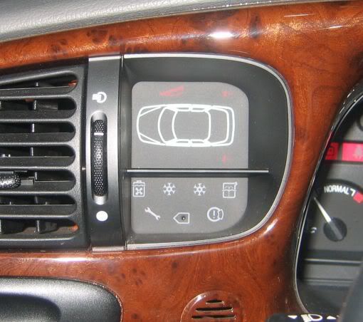

I have a 1997 V6 Mondeo - ex- Japan spec car - has a cluster with the 'spanner' symbol on it as per the picture:
http://i43.photobucket.com/albums/e367/kiwiford/IMG_3912x.jpg
I have a handbook for the car but it does not cover this installation - can anyone advise me please is the 'spanner' symbol a check engine light or is it a 'time for service' light?? The spanner light has just illuminated. I have hooked an OBDII scanner to the car - no faults found (but thats not to say this scanner knows everything!!). If it is just a service engine reminder, how do I reset it??

Didn't know Mondeo's had a spanner diagram.
This might help.
http://www.ilexa.co.uk/forum/index.php?board=11;action=display;threadid=352
" Re:Service Light on Mondeo
pull out the glove box and behind there is a button with a spanner on it hold it in and turn the ignition on keep finger on button till light goes out about 20 sec does it this should work i did it last week on a 1996 td". Eugene Walsh.
