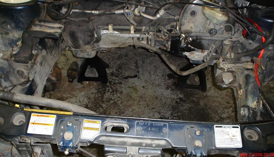

We got the motor pulled out of the sable (at the work garage), had to drop the motor out of the contour due to heighth at the home garage.
Both motors are out and parts are being swapped for the 3.0 drop.

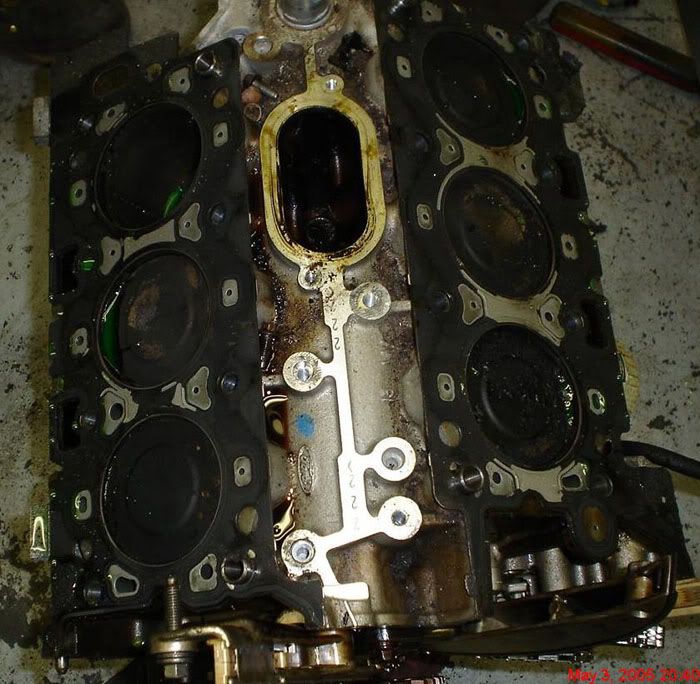

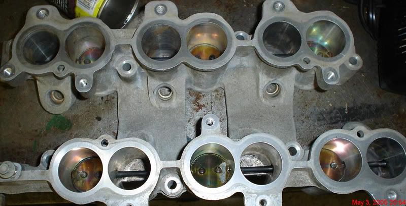

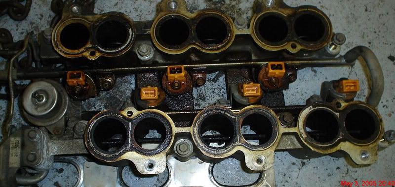

Here are some pictures of the 2.5 w/ the heads off (Had to get the top motor mount off).
<<< --- Off the 2.5, look how dirty
<<< --- Off the 3.0, after we dipped it and cleaned it

We used the top motor mount off the 2.5 and had to take the right head off of the 3.0 to get it on, rather than cutting it/weakening the mount. So we got that off, had it in time, ect.
Well seems since we used the mount the fuel rail on the 3.0 won't fit w/o modifing it/the mount so we're doing that in the next day or so. Got new plugs, wires, oil, oil filter on, its dropped in, now I need to wait in order to get the electric water pump orderd, do the rest of the wiring, ect!
We compression tested all the cylenders, all firing over 200.
I'll keep posted, and I'll get some pictures up here ASAP!
