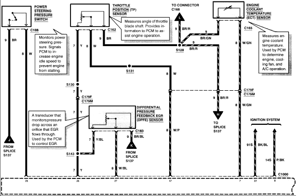

As stated above I changed out my alternator and must have done something to my ECT wires it has no power now and is turning on the fans. Does any one know the wire harness it goes through.

Check the ECT connector is secure and the sensor has not opened up (too high resistance). I think the sensor is about 1Kohms cold (can't remember exactly). This 1995 (yours may differ if not a 1995)diagram shows one wire leads to the TPS and the other goes to the PCM connector [image][/image]
