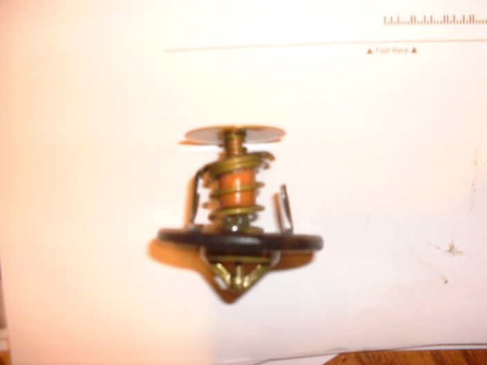

Well i pulled off my old thermostat to replace it and I'd say it had some issues.
I replaced it and I think my problem should be solved now. Lets hope so anyway.
