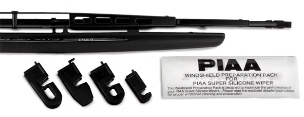

I just bought like these PIAA Sporza Wipers, they are awesome!
