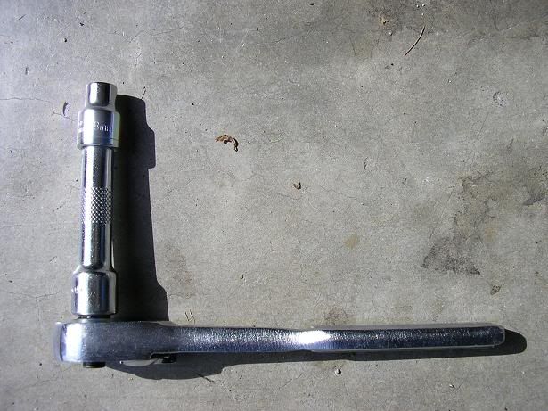

Rachet and 8mm socket(maybe different size for other years/models).
Pic shows optional extention, which makes the job a little easier.

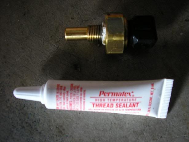

Thread Sealant. About $5 at your local auto parts store.

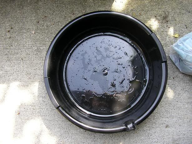

6QT pan - used to catch the water/antifreeze under the car when removing hoses, temp sw and thermostat.

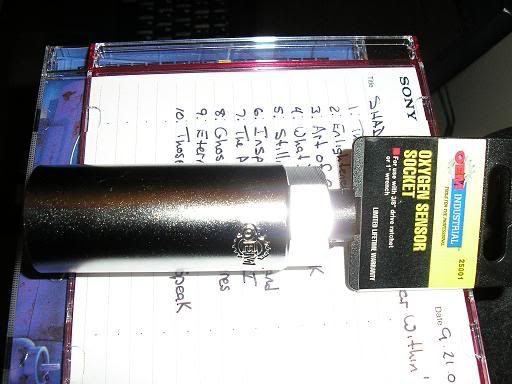

O2 Sensor socket - it's a 7/8 Deep socket and fits perfectly for the Temp SW/Sender(the one for my year/engine anyway...)

Place the 6QT pan under the car, right under the thermostat housing to catch the water/antifreeze.
If you have an old towel to spare, I recommended putting it under/around the pan to absorb any water that may splash around the pan.

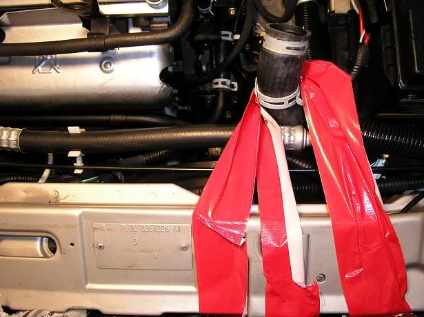

Once the hose has been removed, using the duct tape or bungy cord, secure the hose and out of the way as shown.
Radiator hose that goes to thermostat housing:

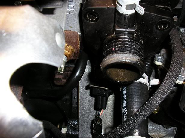

Thermostat housing face with hose and bolts removed.

Now, get the new Temp SW/Sender and put thread sealent on 3/4 of the threads.

My Temperature SW/Sender was the first one shown in the picture below. It has a clip retainer on it.
The part I got at the Auto Parts store(CSK / Shucks Auto) was: NIEHOFF - PN# TS83051
*My local Autozone doesn't stock it and has to special order it...
Various Temp SW/Sender for the Contour
