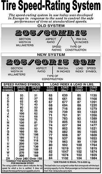

You can also get your Speed and Rev limiters increased but make sure you have the proper rated tires to exceeded 105mph.

You can exceed the speed rating. The rating is for extended periods of time. I've done 130 on 112 rated tires. My hood flying up (cf hood w/ no hood pins) was more of a concern than the tires.

damn mine are y rated tires but i wont ever be going 188 mph, 140 was fast enough weaving in and out of atlanta highways with 4 buddies along with me in thier cars,,,,whooooo that was fun...but wont ever do it again!
