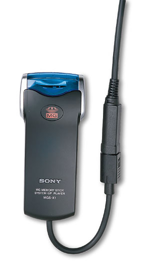

Sorry, no AUX inputs on the C90. You're probably thinking of the 3 pairs of pre-amp outputs or the optical digital output. There's nothing on the input side. The changer has its own special plug. It's like 10 or 12 pins and looks nothing like an AUX input. I guess you could get something like this memory stick player, which the C90 will recognize as a CD changer. But, you've got to deal with the whole memory stick crap instead of having a huge hard drive. Sony MGS-X1 Memory Stick Player There are probably some other options out there that will let you switch the signal source for your amps, which would be like having 2 HU's if you added the Neo or Empeg. But, that'll just add more equipment and makes the system pretty difficult to control. I'd probably go some other route.

Originally posted by SVT Colin: BTW, an FM modulator will probably have less of a SQ sacrifice than you think. I'd say when properly set up, the audible difference would be very small. I've heard a few FM modulated changers that I was pretty impressed with. Colin, Can't you explain how the FM modulation will work? I'm not too familiar with it and I was just guessing at it not being very SQ oriented. I did actually look at that Sony add on unit, and its just not what I'm looking for. Plus I really don't want to deal with the Sony mem stick like you said. Thanks for the help
