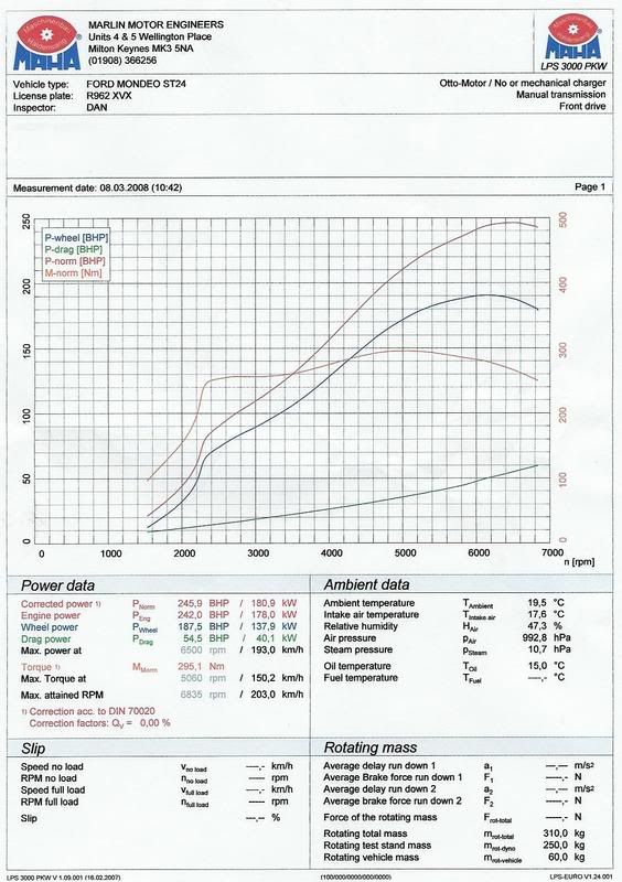

I had my Unichip remapped on Friday & it came out to 245.9bhp @ 6500rpm with 295.1Nm @ 5060 rpm (217.7lb/ft) . Not bad power for a ST24 Mondeo
Heres the graph

Is thi sabout right with what you guys running Hybrids are getting? I'm really pleased with it as the car drives so much better now as the power delivery is so much smoother.
Nice video, and I've always loved your car, Mark! As for power, I guess we're assuming they're using the ~17% drivetrain loss, as here in the states we figure wheel horsepower, where in the UK, you convert to brute horsepower. With that said, it looks like you're in the ~200-205whp range, which are pretty good numbers. With my old SVT, my 3.0L Hybrid put down 206fwhp and 196fwtq.

EDIT: Okay, I looked a little more carefully at your graphs. It says you put down 187 wheel horsepower. I'm wondering how they're converting to bhp?

yeah it looks like they are using about a 23% drivetrain loss, which is way to much. the MTX-75 only has about a 13% loss.(based on stock dyno runs ive seen) :shrug:
still looks like pretty decent numbers though.
I've never seen a stock CSVT with 174WHP so Ithink your 13% is a little low.
17% like Mark said above is much more accurate.
the few i have looked at must not really have been stock then. if thats the case then i am somewhere between about 240 and 260BHP in my zetec :crazy::laugh::laugh:
