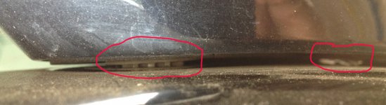

I finally got around to starting the spoiler repair, but hit a snag (wow, go figure….).
I got a pop river out on each side, and got the end nuts off. However, when I try and lift the spoiler off, I see there are 2 plastic clips (on one each side) holding the spoiler down. See the picture. The clip circled on the left is the piece and I am not sure how to approach this. Pry it off ? THe circled item on the right is the bolt that I got the nut off of.

No Title
I hit a snag. After getting the nuts off the covered bolts on each side, there seems to be a plastic clip (circled item on the left) on each end holding the spoiler on the deck. How should I get the spoiler off ?

Got it ! I had to go to the junkyard and practice on a car there. The grey clip stays with the deck, you need to pry the spoiler away from the clip, and it pops out. I will write up a how-to.
