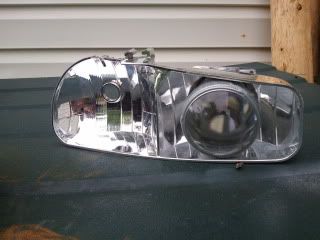

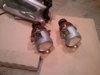

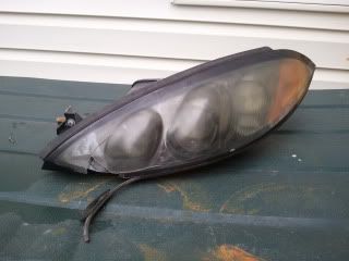

This is my first time attempting this, and i plan on making these adjustable by mounting them to the chrome piece in the headlight so they wont have to be perfectly in place when sealed.

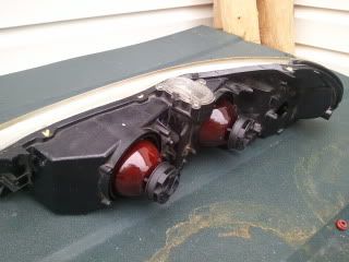

i started off with a set of broken mercury cougar headlights from the junkyard

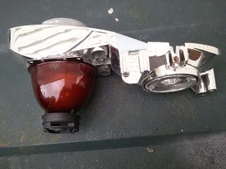

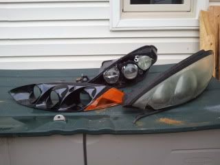

cracked them apart to get to the projector
They have alright fitment, but i have some experimenting i want to do to make a shroud around the projector.
i watched online that you can bake an acrylic sheet and slam it onto were you want to form and it hardens around whatever you want it to cover, then you just cut it for the projector to see through and glue it into place. so i'm gonna give that a try.

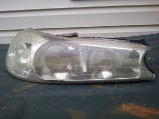

and yes, my headlights have to be cleared up a bit.

One other plus to this, is you can just use your contour headlight bulbs that you already have. The fit right in when I was comparing bulbs.
I was thinking, why would I want to use Cougar projector lights. If I did this, I'd want some really good ones. Then you said this statement. Totally down for that. Rather not have to mess with any kind of mix and match with bulbs and wiring and whatever.

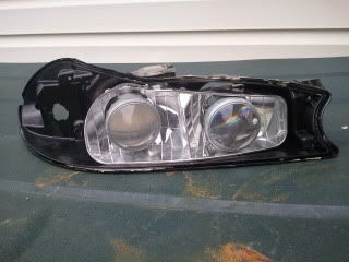

Do all Cougars have these exact same lamps? Also, are the high and low beam lamps the same units? Nice work thus far and thank you.
The cougars came with either one projector or quad projectors. So you have to find the quad set. And the high beam and low beam are the same except the low beam has a metal shield inside covering half the projector for less light output due to it being the "low" beam.
