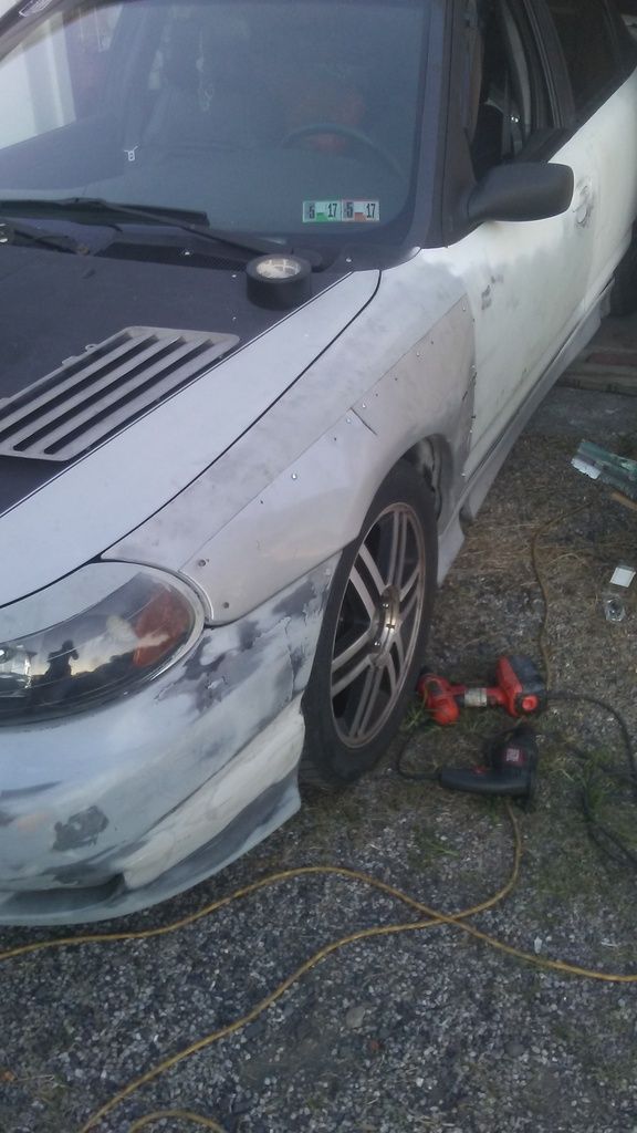

So...as some you know (via facebook) I am in the process of widening the body of #6357. While I wanted to wait until closer to completion to post progress and pictures, I have some down time so might as well do it now.
For starters, we'll take a look at the front bumper. I took a 2001 Mazda Milennia front bumper and molded it into the SVT bumper. And during that process, I picked up an F-150 bumper filler, cut it in half, "soft mounted" to the Mazda bumper, pieced back together and made a splitter/lip. Unfortunately had to remove due to hitting a raccoon and breaking it. Back to the bumper... Once the fusing and rough filler work were done, I cut the lower grille section and sides off another SVT bumper, mounted and fused them to the sides of the existing bumper, filled, sanded and primed and is now ready for mold making for fiberglass with tabs to use the stock SVT mesh. As of now, I'm waiting to order NOS Milennia fog lights and the correct size LED bulbs.
