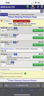

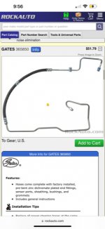

Can't you just get a whole new line from rock auto?
Those fittings are hell. I’m pretty sure every contour I’ve seen leaks from there. The swivel action leaks. I remember I had a ford freestyle with the same setup (3l car) I was able to source all the replacement parts. Try rock auto

as stated before, i'm pretty certain every contour/mystique i have ever seen has leaked from here as well. this is a common problem for sure. i haven't replaced my power steering hose, but i know for certain that if you just lower your subframe most of the way this hose is more easily accessible for replacement. it will still be a pain, but you will at least be able to get your hands in there. again as stated before, finding the part is going to be difficult. of course, unless you go the cheap route and buy from rock auto.
