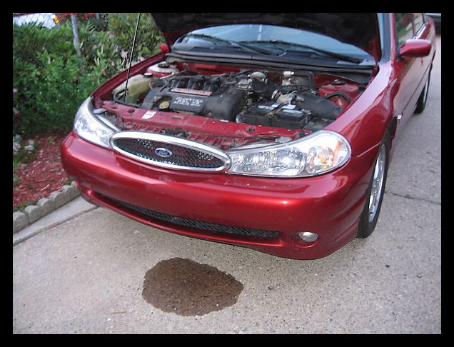

I was supposed to drive my dad's T-Red SVT across Michigan Thursday after his shifter repair - the result of a failure mode that apparently leaves a chunk of a bolt in the trans case. The repair shop said the chunk would be caught by the drainplug magnet. I had serious worries about driving 75-80 mph (OK, 143 mph :cool:) in the car. (I also spent 6.5 years as a transmission engineer...) Sure enough, with my wife behind me in the Grand Caravan, I take the car up past the secondaries in first, and about halfway up through second, I hear this pop pop pop, BANG!

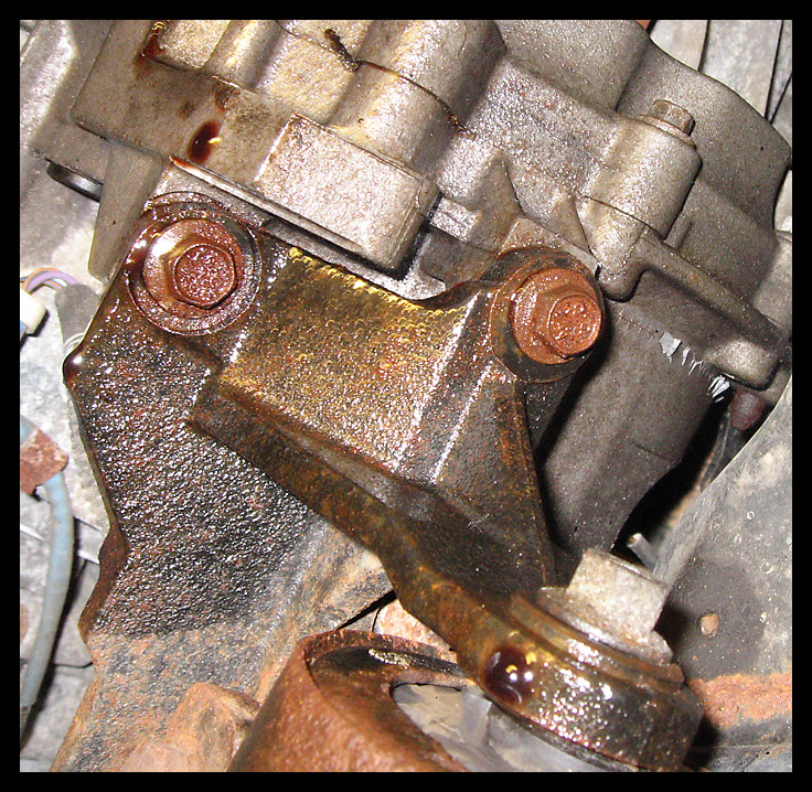

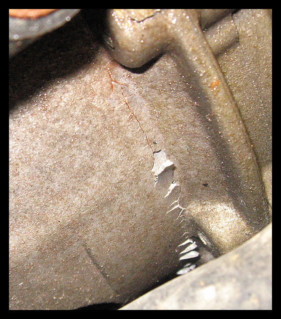

Getting off the throttle, engine braking in gear, I kept hearing a pop pop pop at irregular beats. Limped it back to my house. Tonight I rolled the car back and found the ATF bloodstains in the driveway. Confirmed a major tear/crack around the ring gear/trans case. I thought the bolt chunk got stuck between the ring and pinion. Thought wrong. Check out the pics.

Do a search for Terry Haines. He likely can supply a core as well as rebuild it for you in a manner that this will never happen again. It sounds like you had the shirt tower bolt break and did not retrieve the head of the bolt. That was a "must do", even if you needed to pull the trans to get it.
You can also read various posts about repairing the MTX75 model transmission and determine if you want to handle it in some other manner. Check the classifieds and see if someone has a trans for sale.
Like Jim said. Sounds like you had a shifter tower bolt failure and then continued to drive it. :blackeye: Then said bolt piece caught a gear set and fractured the case in the process. A new MTX with LSD is the best course of action here. Only ~25% more expensive then the bare minimum fix! Terry is the man for CDW-27 tranny work. Could not tell you if any other place like BAT still sells full MTX's.
