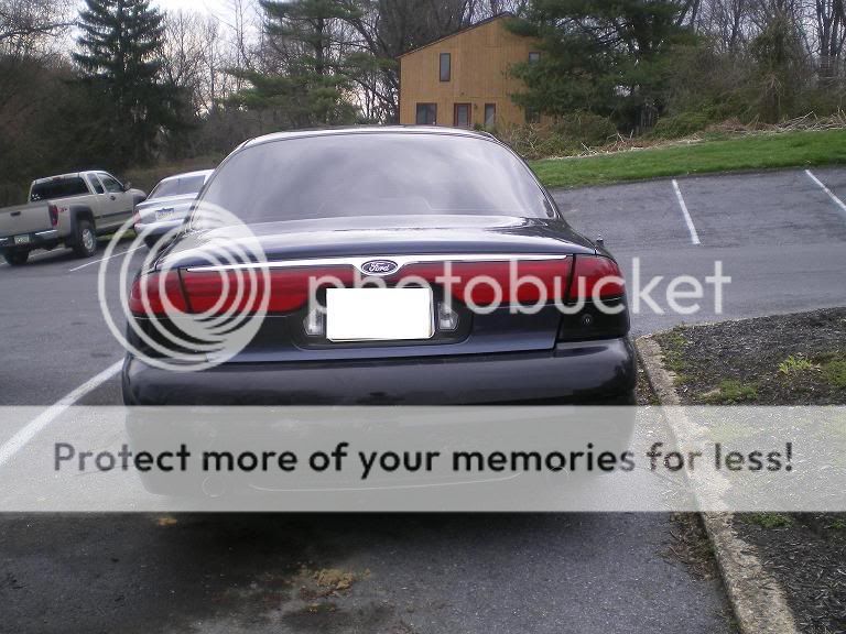

Car looks really good, what did you use and how long did it take you?
For the bodywork, i used firbeglass resin on the back bumper, bondo bumper repair kit on the 2 cracks in the front bumper, and im going to be putting more resin on the inside on the front bumper when i get time.
for paint, i used deltron universal black. and i think the clearcoat was also deltron, i forget.
Looks good..Did you have to wet sand and buff the final product?
For that being your first time painting, how did you like it..
I do alot of bumper and fender paint quater panal painting i still like it for some reason.
didnt wetsand it, just buffed it. i wetsanded it between basecoats though. and I liked it, wish i had somewhere inside to do it though

It looks like a decent job from the pictures. I'd like to do something like this with my front bumper and hood. What's your secret method?
dunno pretty straight forward, fix bumpers, sand 80, 150, 400 then 600 grit, clean well, a few basecoats, clear coat or 2, boom done.
got any leaves or bugs in your paint?
yes alot, as it was drying i just stood at the front of the car and jumped around blocking leaves for about 20 minutes as it was drying. neighbors prolly thought i was crazy.
