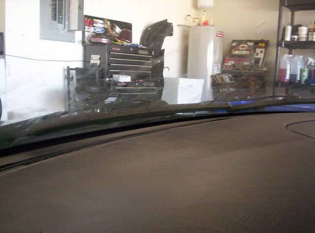

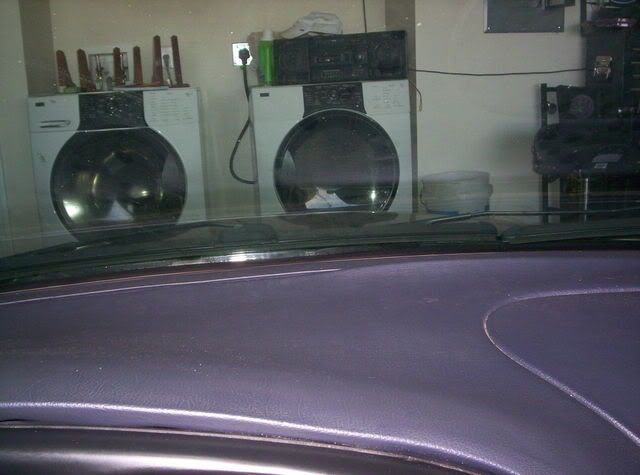

Well my dash warp wasnt that bad but i wanted to deal with it now before it got bad..I purchased a warp kit from Bill at Team Ford..I was aware that i had to take the dash somewhat out and i wasnt up for that..So instead i installed the clips and new vent and Bada bing no more warp..I was reading somewhere on here the other day a Fellow CEGer did the same thing..I do not think it will come back but if it does i have the rest of the kit and will install it..
Here you can see half and half..
looks pretty good but that wont hold it for long. be ready to pull the dash and finish the job.pulling is not that hard at all ive pulled around 5 dashes fo far and would only be a couple hrs to pull -fix -and put back in.

Yeah screw getting another dash..Just get the dash warp kit from Team ford..We will do it just like i did and im hoping mine dont come back but if it were to i'll just install the metal plate over top..So with yours we would install the plate the first time.
