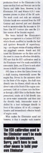

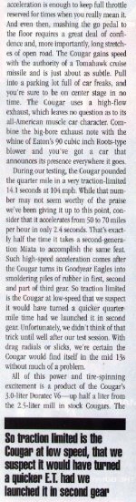

Yup, there were a few versions of the "Eliminator". One had a centrifugal supercharger and the other used a Eaton roots supercharger exactly like the one above. I have both the magazines they were in (Sport Compact Car). The Eaton roots setup above received rave reviews. They said it accelerated 50-70 like a tomahawk cruise missile. It was faster 50-70mph than any car they had ever tested up to that point. Obviously, it was traction limited down low so 0-60 wasn't a high point. They said it was so traction limited that it would turn better 1/4 mile times if it was started in 2nd gear.

The original Eaton setup ran off of a jackshaft like the Vortech kit which went across the motor to the pulley side. It didn't run off the cam pulley. I guess it's hard to tell in the picture above what it's running off of. The jackshaft may not be installed in that picture or it may be a different setup that does in fact run off of the the cam pulley.

Your description of the 50 - 70mph acceleration is exactly what i'm looking for from my build :laugh: ...G.

attachment.php
I wonder who did this install ^^^, because the Paxton Automotive mentioned in the article below, talks about COP and the timing advance issues (dwell ??)

Stranger still, they both seem to use the driveshaft method .. G.
p.s. this
Controlling the spark advance in the coil-on-plug Duratec system was also a challenge. To prevent engine-damaging detonation, ignition timing must be retarded 0.75 degree per pound of boost. No off-the-shelf solution exists to do this with six separate coils. Since Paxton's competitors may still be seeking the answer, the company wouldn't reveal its solution.
