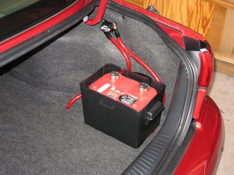

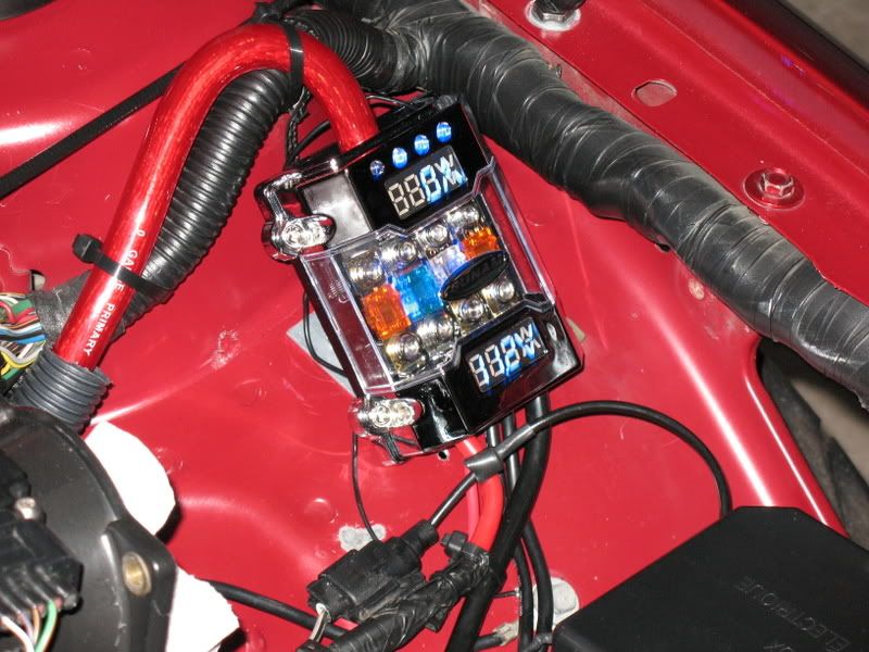

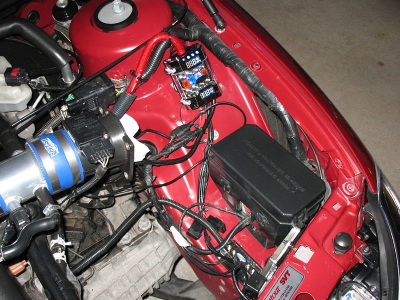

a few pictures of the battery relocation I just completed...

I just have one, maybe really stupid question. My fuse box does not equal your fuse box. :confused:

Did you upgrade the big 3 and swap the box?
I read the link and thanks for the advice...the battery ground is obviously done, but the other two haven't been, yet. I'm on my second distribution block and they are sending me a third this week...Tsunami reliability has been a little poor...the first block never lit up, the second one did, except for one of the status leds, so now they are testing this one before sending it out...

Thanks! :) That is pretty cool about the similarities...I ran the power cable through the subframe connector and then crossed over at the rear subframe following the factory routing...I can post pictures from underneath if you want ideas.
Hey Paul, Is this a kit you bought or did you piece it together. Im not really familiar with two pieces: the Distribution block and I guessing is a cut off in the back before it goes to the battery? What is the two items and what are they for?
