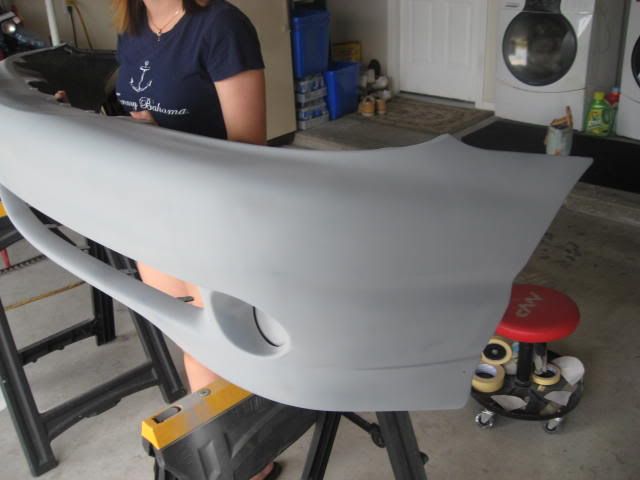

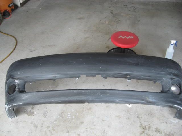

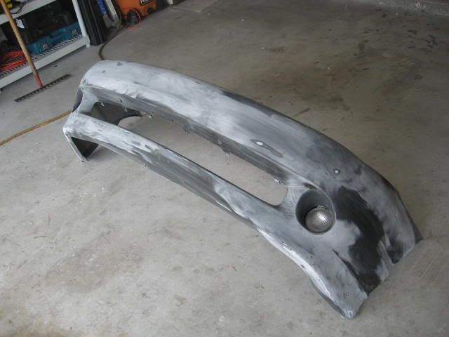

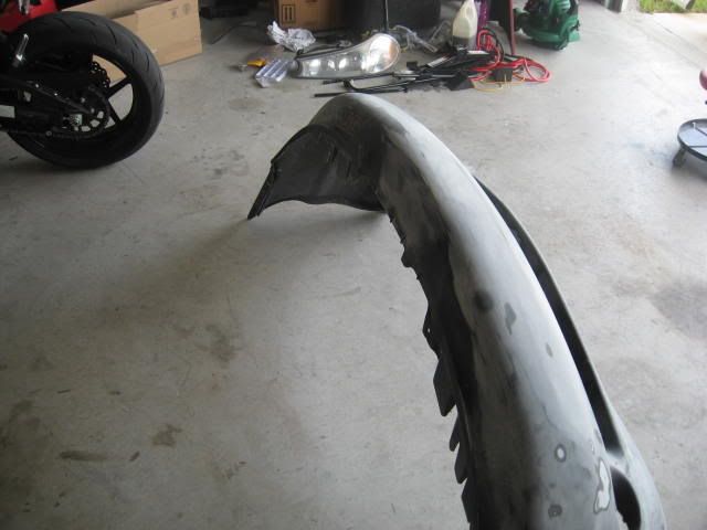

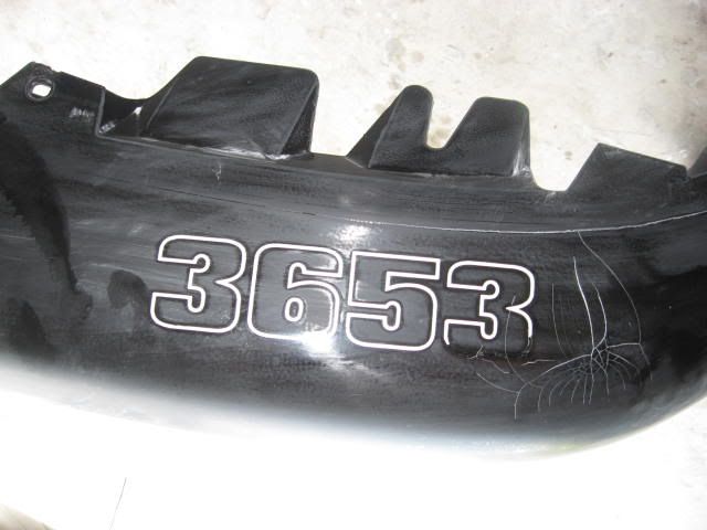

Well The other day i started doing the prep work on a blk SVT front bumper from to change the color to SF..
There was a ton of rock chips and a few good spider cracks around the bumper..
The last of kyle AKA holyrollerz 3653 front bumper.

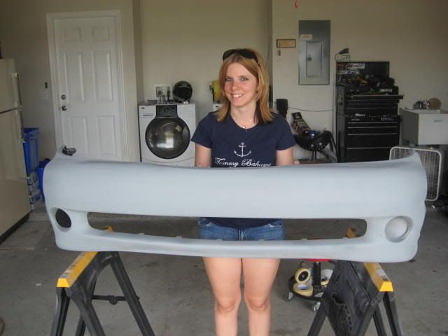

My girlfriend holding the bumper for to me take a pic.

As you can see from the pictures the bumper was just laying on the stands in the pictures..Worked great

That looks really good...great job. What do you use for the rock chip holes?
Basically sanding down the bumper and useing a Body filler AKA mud..then smooth that out and primer it up..

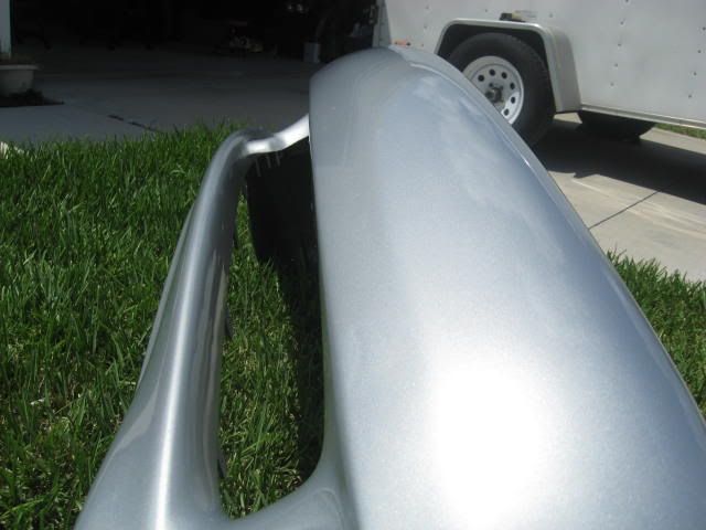

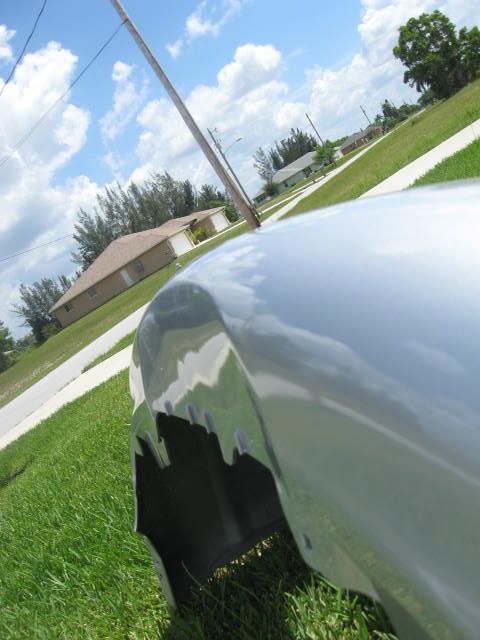

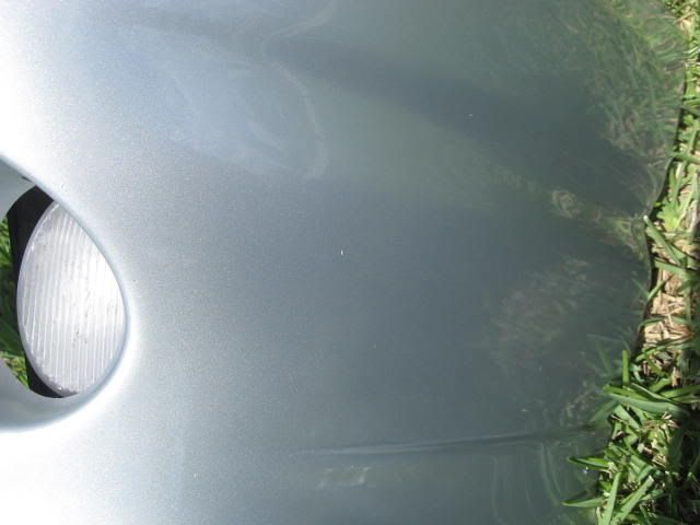

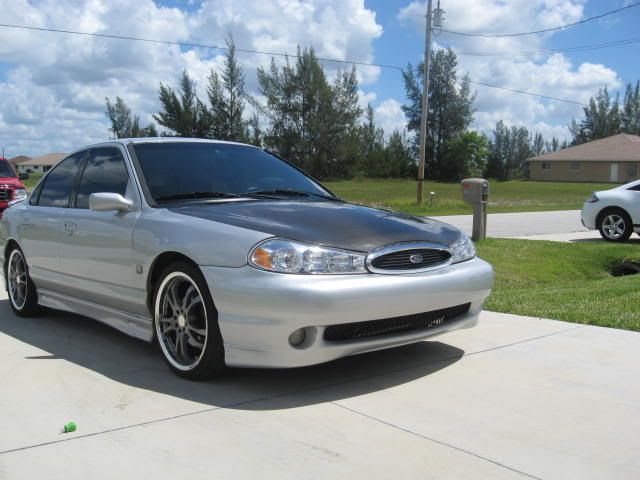

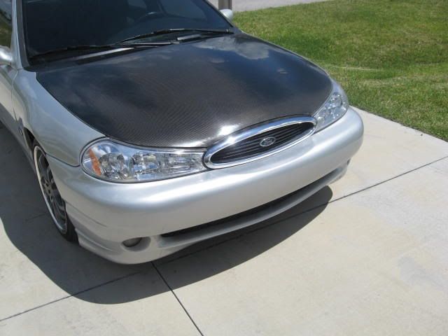

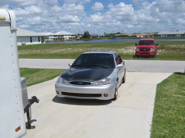

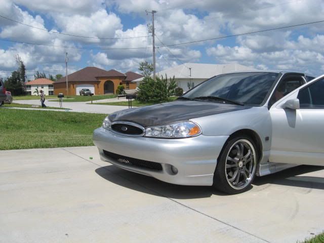

Well the bumper is on the car..Here are some pictures.
Cody was extremely happy with the work done. we will be paint his rear reflector next week in SF..

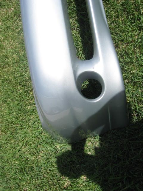

nice bumper :drool: but what are the spots next to the fog light holes:shrug:
