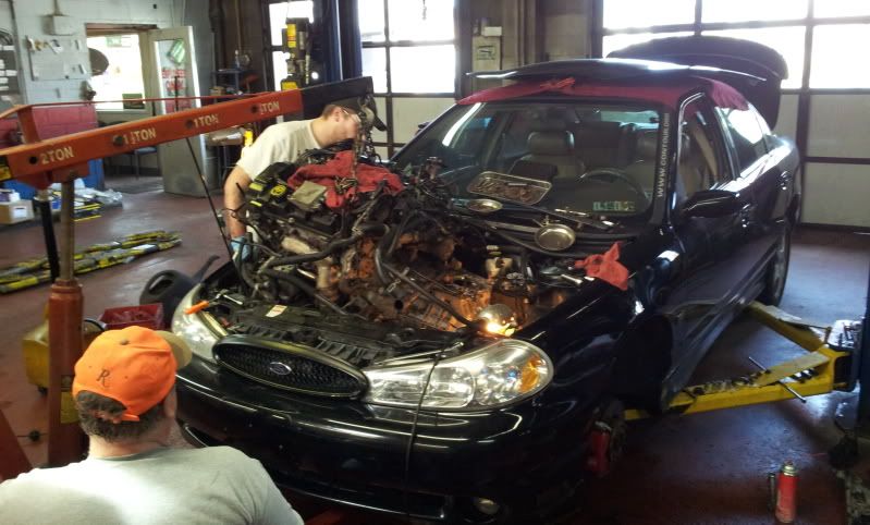

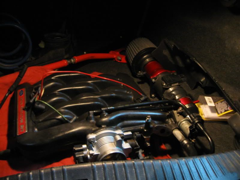

Here is a progress shot after an hour and a half.
My wife playing with her phone.
All fluids are drained, just about everything is unplugged, Y pipe is off, RR's are out, and a few other things that i cant think of right now. Should be out tomorrow by 1pm or so.

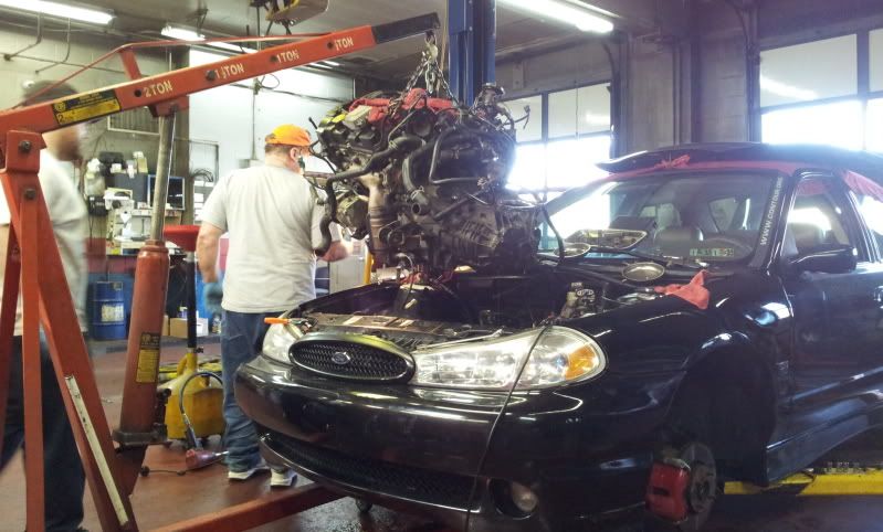

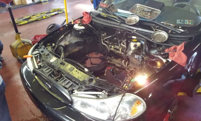

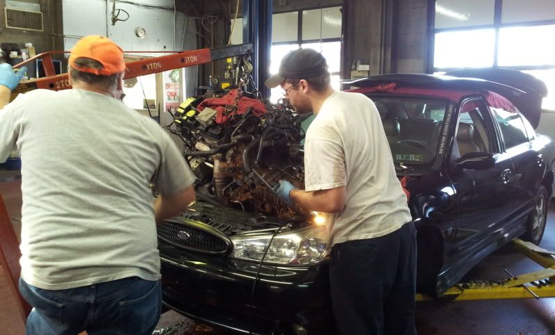

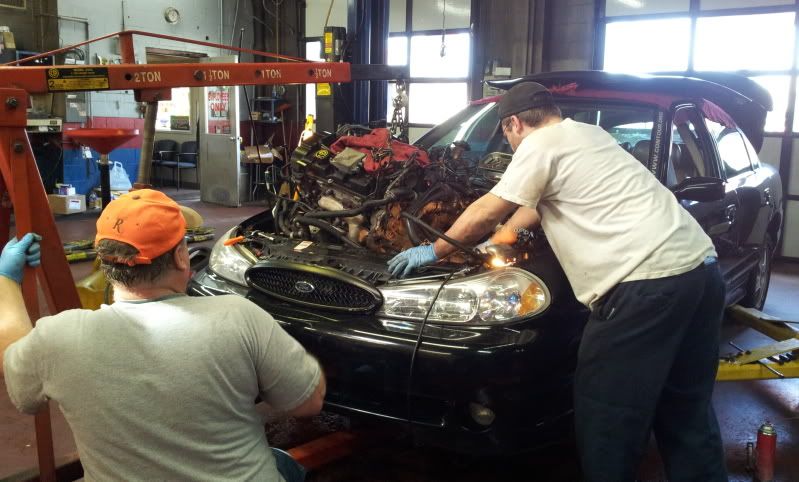

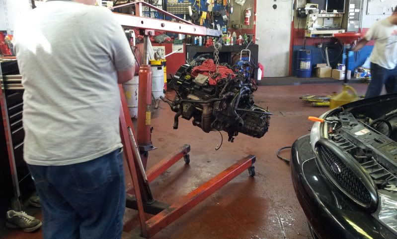

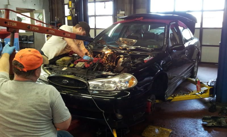

Update: Got the motor and trans out by 1:30, started at 10 this morning, so total time 5 hours. Not so bad for my first time i guess. I'll have pics up later.
