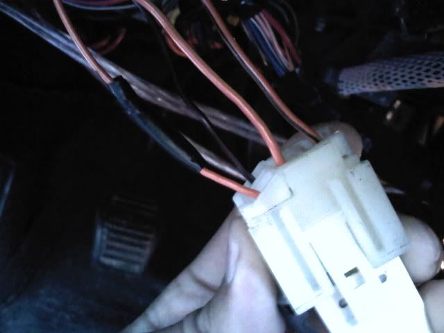

here are the pics......you can see i cut the all orange wire.....tried connecting it with the orange and black and my lows stayed on.....

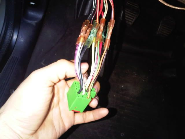

and here is the connector that leads to the light switch....has someone been f#%% with them or are they suppose to be like that?
