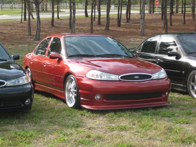

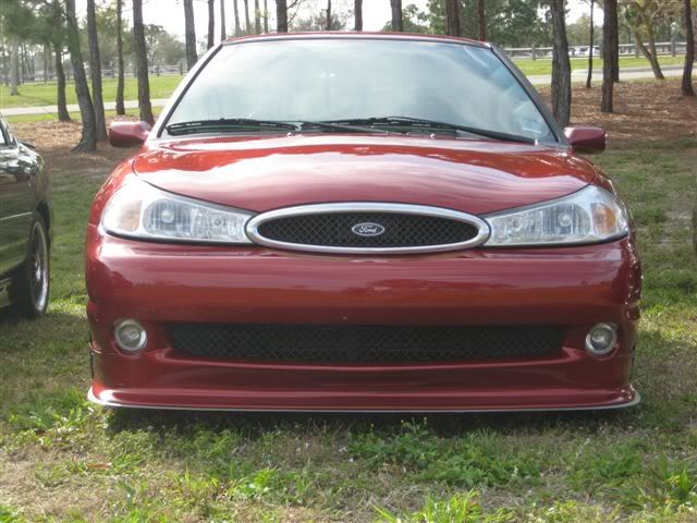

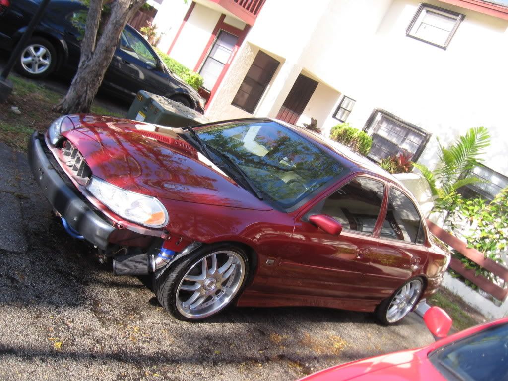

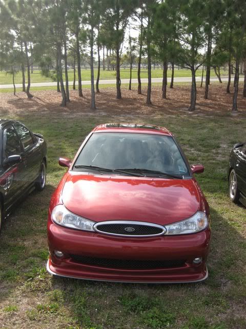

Well my car is almost back on the road again and Ive been promising to post pics of the car for quite some time now. I am comfortable posting pics of how it sits at the moment but there is a few more things I need to do before I get it back on the road.

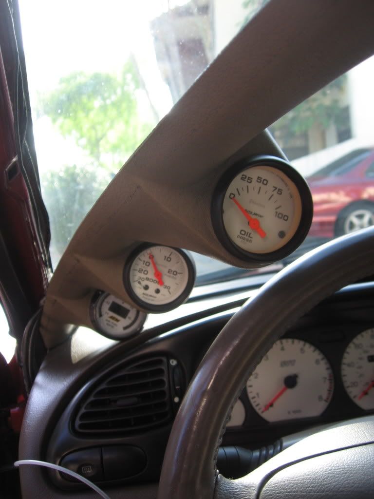

-I need to finish wiring the guages.

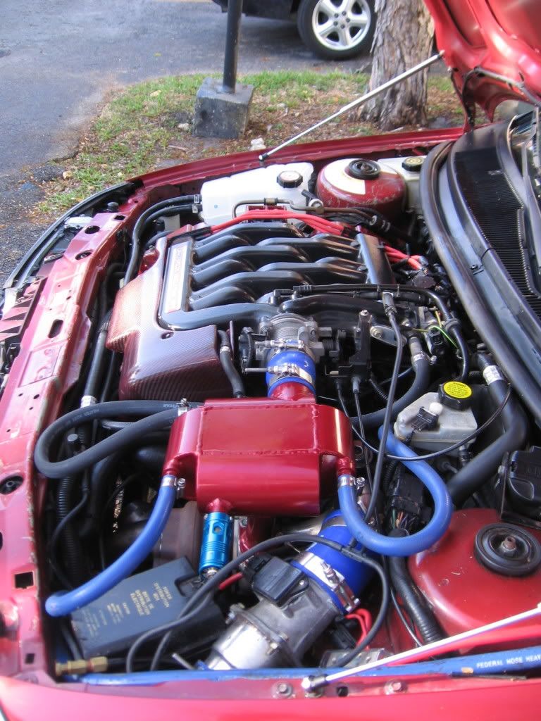

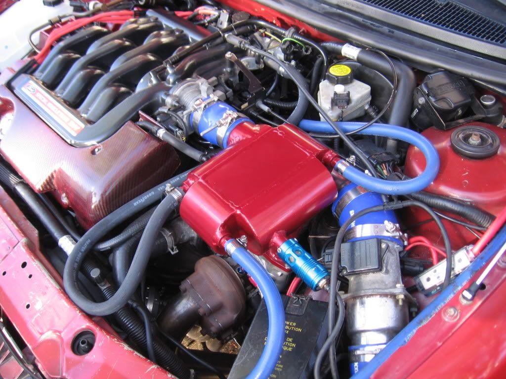

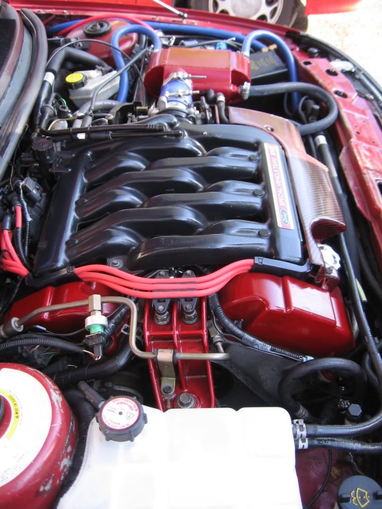

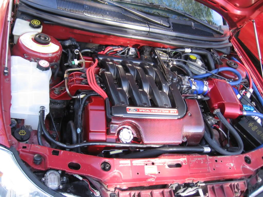

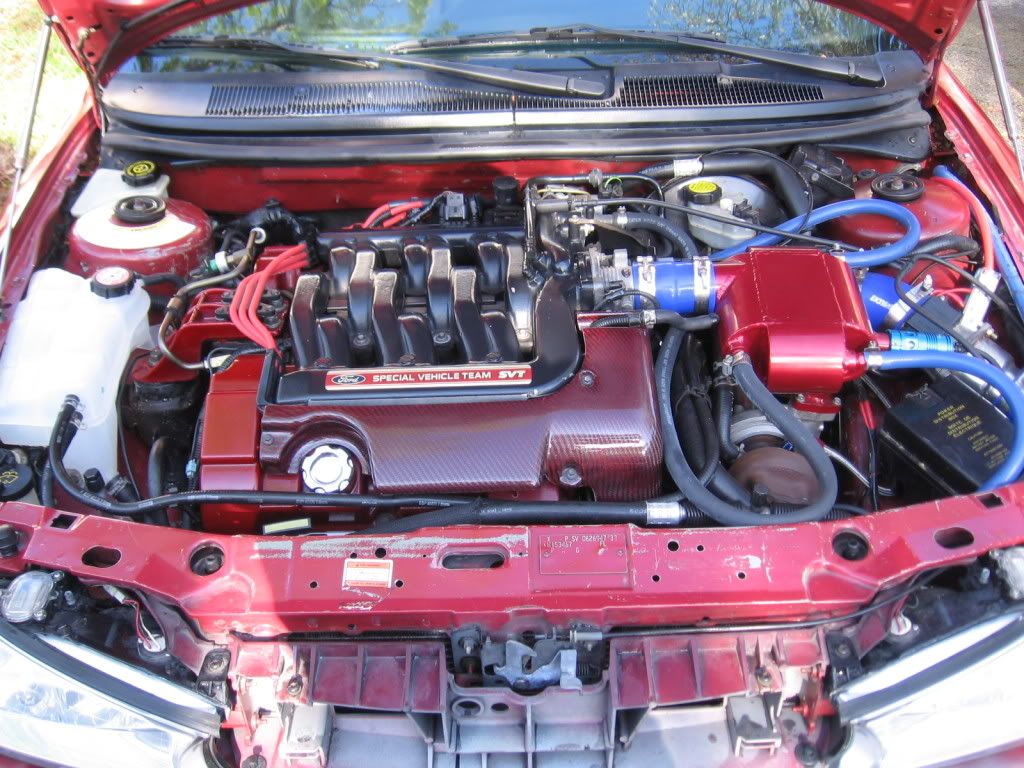

And the much anticipated engine bay pics.
Mods are as follows
3L block
SVT oil cooler
"kinger" N/A cut pnp heads with st200 valve springs
SVT Cams
SVT lower, SVT upper
"Buckshot" ported SVT TB
FMS 9mm wires
NGK TR-6 plugs
Red CF IMRC cover
"Powdercoatjosh" powdercoated valve covers
"Blu Fuz" powdercoated engine mount
ADC T-28 turbo kit
-Garrett T-28 Dual ball bearing liquid cooled
-Headers: 321 Stainless headers, 304L downpipe and intake pipes
Downpipe includes flex and 3" high flow cat
-Filter: 7" K&N
-Intercooler: Liquid to air
-Blow Off Valve: Turbo XS types S
-Wastegate: Tial 35mm divorced wastegate by Garrett
-Heat Exchanger: 8 pass 1/2"
-Reservoir Tank: 4 gallon aluminum reservoir tank, with aviation style lid
-Intercooler pump: 198 gph
-Injectors: 6 30# Ford
-Spec stage 3+ clutch
-Fidanza flywheel
-Quaife LSD
