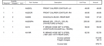

- Master Cylinder w/o reservoir - From NAPA (I contacted many suppliers, even Ford, and could not find one w/reservior) - because I was having to pump my clutch almost every day to be drive-able, not to mention the brakes felt like crap.
- Rotors, Pads, SS Hoses, Front Calipers - From BAT Inc (parts list in image below) - One problem I ran into with the front calipers is, before I bought the car the previous owner had put Mustang brakes on it. When the calipers were being installed, I needed the spacers from the SVT calipers so they would fit around the rotors, but didn't have the original SVT calipers. I had to pull them from salvage to get the spacers. Rear Calipers - From NAPA and had cores - They fit without getting spacers (so they must have been svt calipers not standard Contour calipers). The NAPA calipers came black coated, whereas the BAT calipers need to be primed and painted.

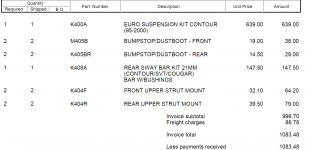

- Struts and Springs installed - From BAT Inc (euro kit, F&R dust boots, F&R upper strut mounts)
- 21mm rear sway w/bushings and links - From BAT Inc
