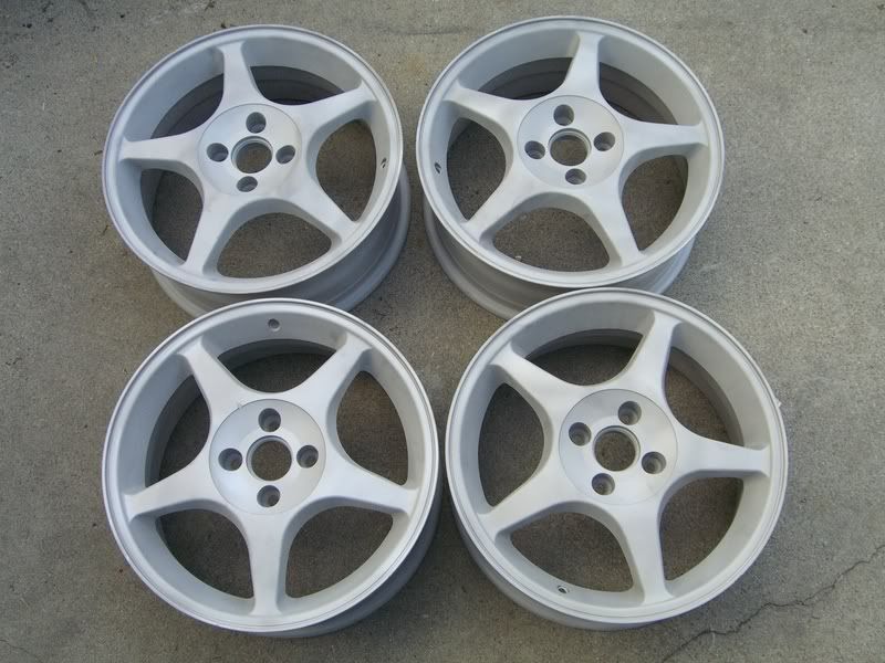

Here's my quasi-how to, 3rd set of wheels i've painted, 1st set that were alloys.

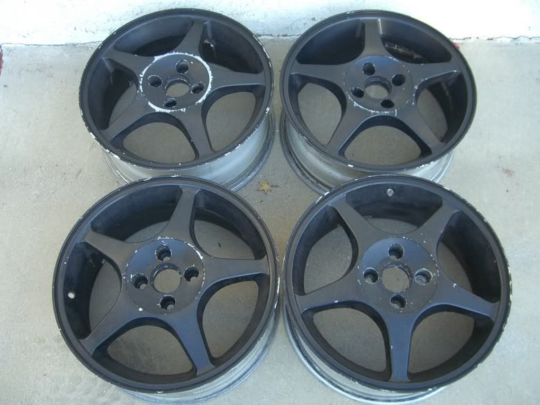

I got them with some crappy black paint that was scratched and peeling:

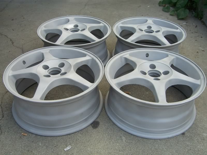

Then had them sandblasted at a local place for $15/wheel:

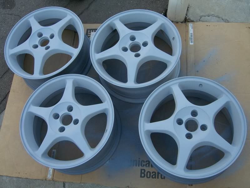

A couple coats of primer for the entire wheel:
After the regular primer, I took some sandable filler primer and made a couple passes over the front of the wheels. I wetsanded with 320 grit to make a smooth finish and lessen the chance of scratching/chipping the paint off due to an irregular surface.

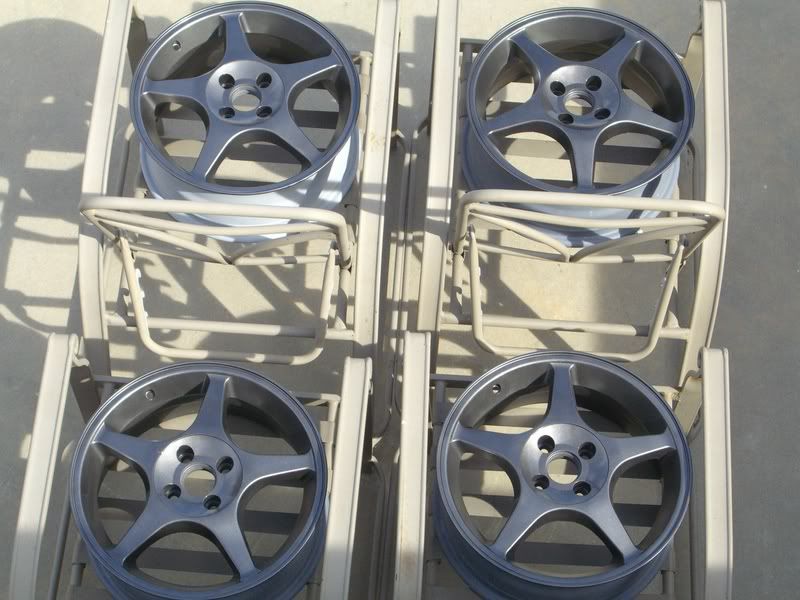

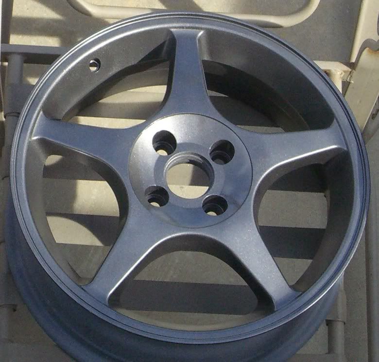

I let the wheels sit for a day or two then put on 3 coats of dark argent silver pepboys "high-strength" wheel paint. This was shortly followed by a high temp clear (2 good coats per wheel). I used 1 can of regular primer, 1/2 can of filler primer, 2 cans of wheel paint, and 2 cans of clear.
Now i'm ready for tires! Check it out:

I really like the way they looked after the sandblasting. I would have been tempted to clear coat them as is.
If the paint can't hang after a couple years (aka next set of tires), I might try and see what bead blasting would turn out. I saw some aluminum racing wheels that looked great bead blasted.

Thanks for the compliment on the color, but i prefer not to powdercoat aluminum alloy wheels. I live in LA where the streets might as well be unpaved, also - im kinda on a budget with the car. Spent less than $200 on this project, and that's including the purchase price of the wheels!

Thanks, I initially wanted them to be a bit lighter like this:
but the darker color seems to fit the car well. Stock silver would have been too bright.
