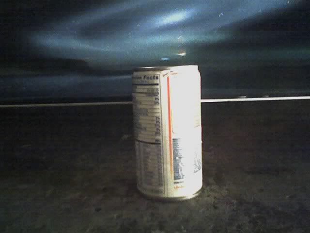

I've currently got Bilstein Springline struts and the rear ones are starting to leak some. I'm thinking about getting BAT struts and I want to make sure my car's ride height won't change. I'm happy with the stance and don't want it to change unless it's a bit lower. I know there's alot of choices but without buying crap to save money, I'm thinking BAT is my best bet quality and money wise. If anyone has pix, I'd like to see them. Right now my Mirko is 3 1/4" off the ground in the center. I've learned how to drive with it on and I'm fine with it.
Horrible picture but you can see the height from the Mirko's skid plate.
