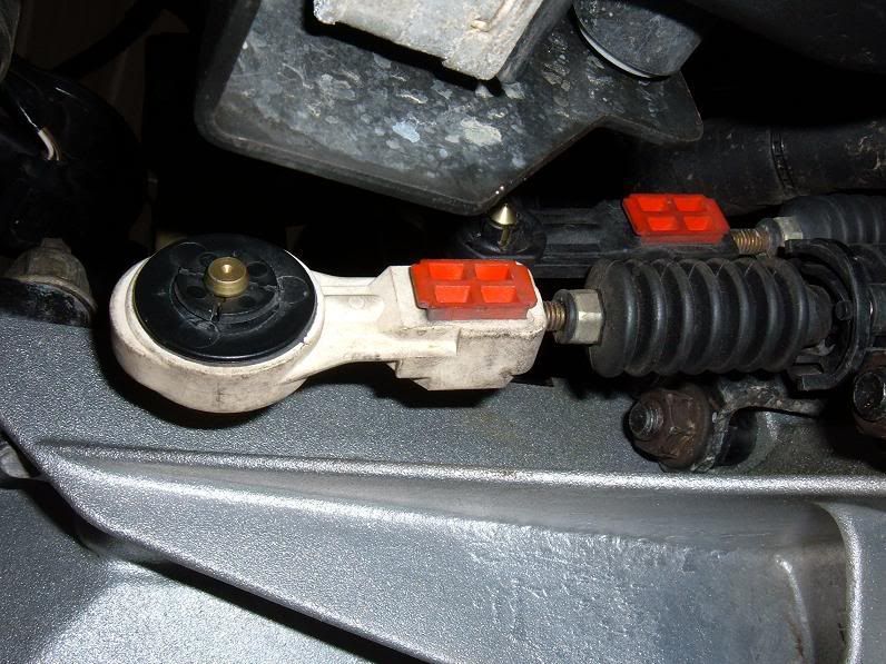

cable adjustment. lookie here!

how do i adjust this cable end?

What I've done that works alright is to pop that red plastic piece out and have a friend move the shifter in the direction that you don't think you had enough slack before. Then pop the plastic piece back in and try it out. I just use a trial and error method until it shifts well through all the gears.
To pop the red piece out just carefully pry on the ears on either side with a screw driver (switch off between sides if its stubborn) until it pops out far enough to adjust the cable.
I think Ford uses some special tool when they do it though.
yea its a rotunda tool. it centers the shifter so it doesnt take 2 people to adjust the ends. i just press the orange pieces in and then have someone hold the shifter in the middle, and release the orange buttons.
i used the two person method. took a few tries and i think im at the maximum adjustment or something but it worked out nicely.

I'm pretty sure that the ends are still available, however many dealers will tell you you need to replace the entire cable assembly as the catalog is hard to read. Check with Bill Jenkins at Team Ford.
For some more insight on the cable ends, go to the old forums and find my old thread "It finally hapened" Please note that I misspelled "happened".

take off CIA, undo tranny mount, press orange buttons in, pull off ends, put new ones on, install in reverse order. you get quicker the more you work on it. i think all you need is a flat head, a 15mm, a 17mm or a 18mm, an extension and a 1/2" ratchet IIRC
