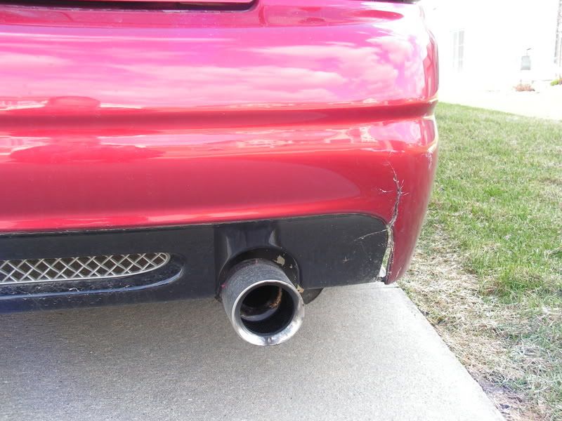

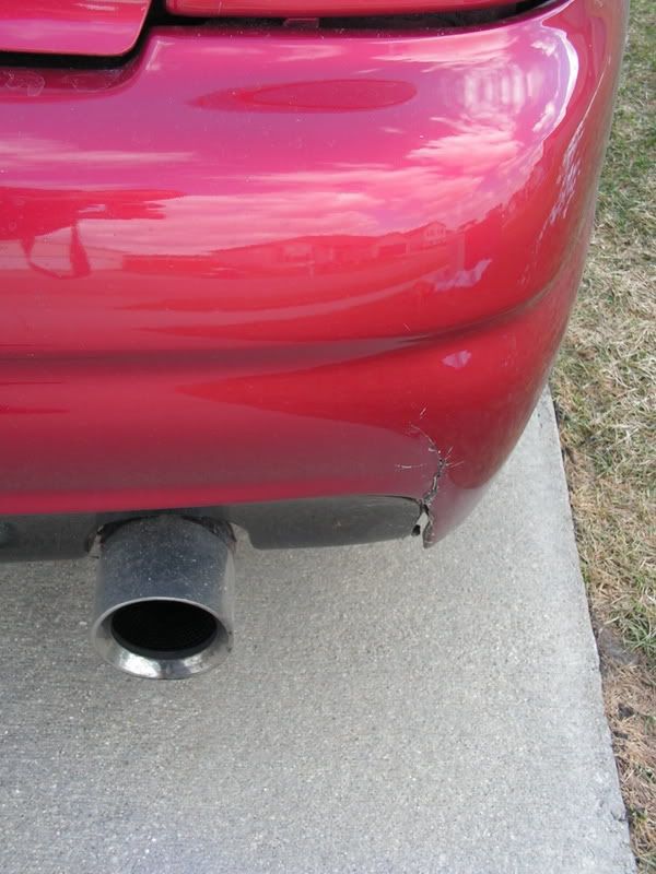

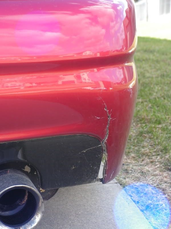

About a month or so ago I noticed there was about a 3" crack in my rear bumper. It is a vertical crack starting at the bottom of the bumper and is between the painted section of the bumper and the unpainted black section that surrounds the exhaust, passenger side.
I have no idea how it formed, it seems too low to be the result of a parking lot mishap, and I don’t recall bottoming out anywhere that would cause this sort of a problem. The only thing I can think of would be the scenario of snow/slush building up under the bumper, freezing and catching when on the pavement when I back out of the driveway. The passenger side clip that attaches to the wheel well also had been broken some where around the same time and I had temporarily zip-tied the bumper on the body so it wouldn't "flap" while driving.
I noticed yesterday that this crack has spread and is now 5-6" and creeping up. I don't have any body shop connections and don't know how to repair it myself. I am planning on removing the bumper this weekend and replacing it with my old SE bumper :blackeye: until I can get it fixed. The SVT bumper was bought used about 3 years ago in good condition and I had a reputable body shop prep and paint it. I don't think this is related to any previous damage, but you never know.
I don't have any pics just yet, but will try and post some later tonight. In the mean time does anyone have any good suggestions on how to stop it from getting worse or an easy way to repair it? I thought about drilling a hole where at the end of the crack to prevent it from continuing, but don’t really feel comfortable with the idea.

Fiberglass repair kit. Just clean the area, lay the figerglass down (on both sides), let it dry, and sand it down. If you can't paint it yourself bring it back to a repair shop.

if you fiberglass over the crack.. it will still crack even more.. you need to drill a small hole at the end of the crack THEN fiberglass it...

See that's just it, it IS spreading and that is really irritating! If it weren't I'd consider putting it off for later, but it's not and I don't want it to get to the point to where it is unrepairable.

o and thanks for posting those pics....u know what my first thought that comes to mind is? DUCT TAPE THE INSIDE hahaha. its obvious that the wind resistance is pulling it apart from the bottom up. so i say line the inside with some duct tape to keep it from pulling, NO JOKE. this will hinder the crack from spreading momentarily until u find a good solution to fixing it, like with fiberglass or something. :D
