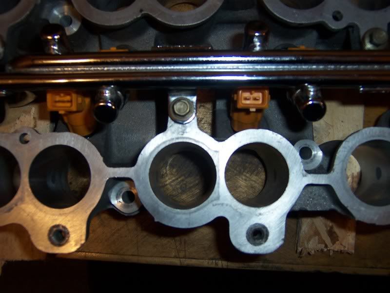

A very small taste of what PRT’s been up to this winter.
Ported LIM:
Butterflies and shafts removed.
Shaft holes filled and smoothed
Injector ports opened up
Custom fabbed IMRC linkage made from modified stock linkage and some hardware store goodies
Alignment pins were also made for proper alignment of UIM and LIM at install

Very nice looking, and excuse me for not understanding, but without the secondary butterfly valves, why do you still have the IMRC linkage? Just doesn't make sense to me. Other than that, looks like awesome quality work! Keep it up, you're doing a great service to all of the CEG.
I believe this allows him to run the car, without having to get a tune for no IMRC. The linkage still functions as it should, and the computer doesn't realize the butterflies are gone. I'm sure he'll eventually get a tune, but this keeps him from having a CEL, right off the bat. Or maybe I'm way off...... :shrug:

that is exactly what I seems to be going on to me ...
