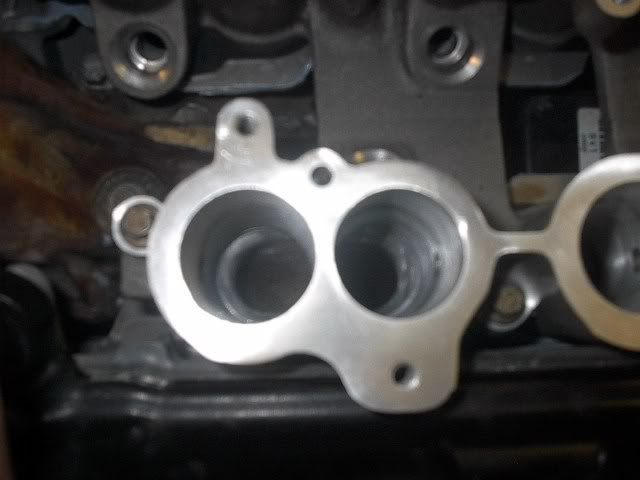

Here is just one of the plates sitting on the heads.

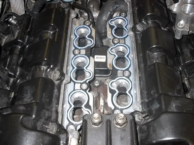

Here is the stock lower intake gaskets set in place adn waiting for the lower intake
Lower intake installed

well that is what i got they were easy to install, and they look great, and i think they will work even better than they look. i will keep reporting as the car is only a few days away from hitting the road. if you couldn't tell i installed them with the motor in the car.
